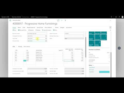

    maybe this video will help, how to manually amend vat
    https://www.youtube.com/watch?v=zBXttdf0byg
    another one:
    https://www.youtube.com/watch?v=qSBdnznrPaE
