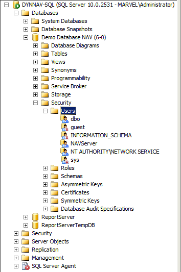

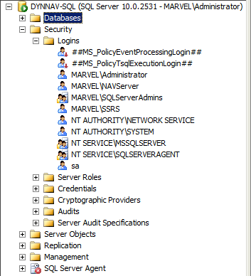

    I have now set up the SQL Server Login and DB User for domain account NAVServer.
