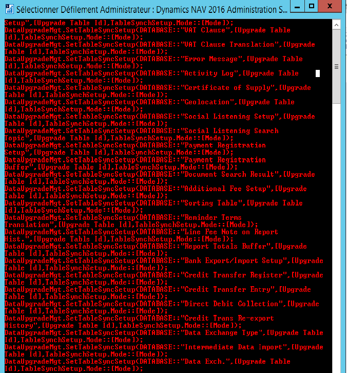

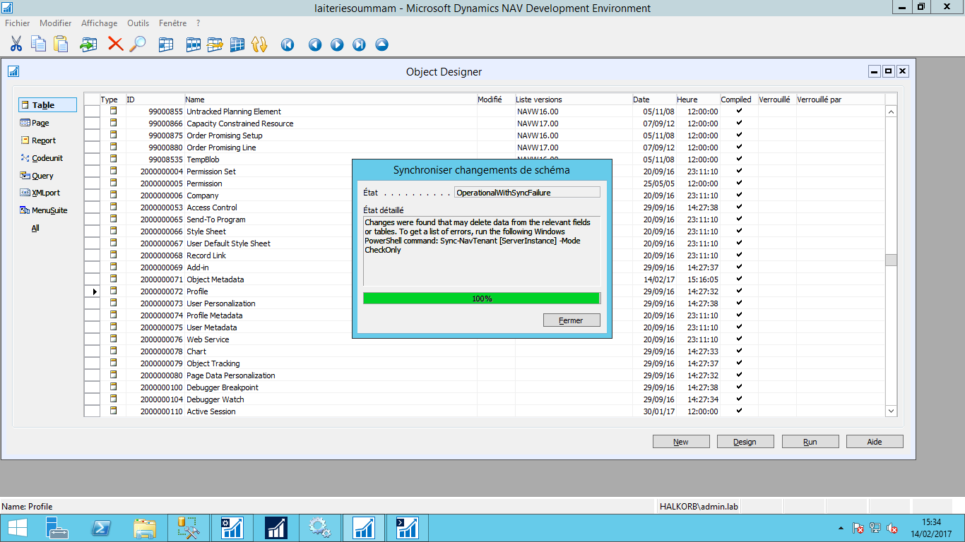

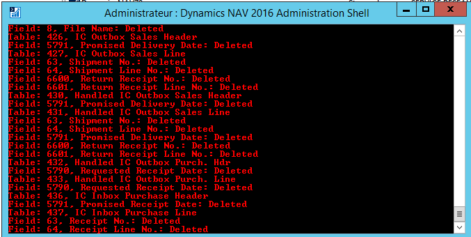

I am Information system engineer, and I work on an upgrade project of dynamics nav 2009R2 to Dynamics NAV 2016. After done all the steps for the upgrade code, I follow the Apllication upgrade, after the data base be converted to Dynamics nav 2016, i create an intance linked to this DB,
I lunch the NAv client envir as admin, I open the DB, and I had tried to synchronize the schamas for all tables, I'm facint an issues, these are screenshots

    So if I am not wrong you have deleted all objects and technically converted to the new version.
    Next step is not to run upgrade process.
    Next step is to import merged objects that are from target version.
    and Then import upgrade toolkit.
    and then start data upgrade. all the tables listed in the error have some design changes which are handled in upgrade codeunit.

    You want to tell me that i must import the merged object before i perform the DATA upgrade process ?
    after getting the merged objects what is the next step to do ?
    for me i have performed the data process to nav 2016 ,
    then i imported the merged object.FOb that i have got from merge,
    the next that is synchronize the all tables !
    I think, this is the process ,
    if I missed some thing, tell me theses steps to follow !
    It's my first experience with Dynamics nav !
    thank you for help!
  • mohana_cse06
    mohana_cse06 Member Posts: 5,506
    you need to import the merged objects before performing data upgrade
