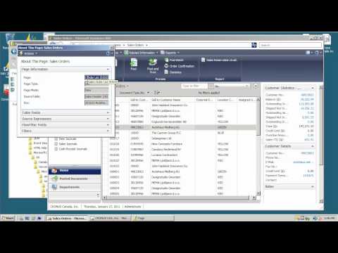

Here's a video that I made years ago about debugging the 2009 RTC -
https://youtu.be/ZonT3rj_EUM 5
