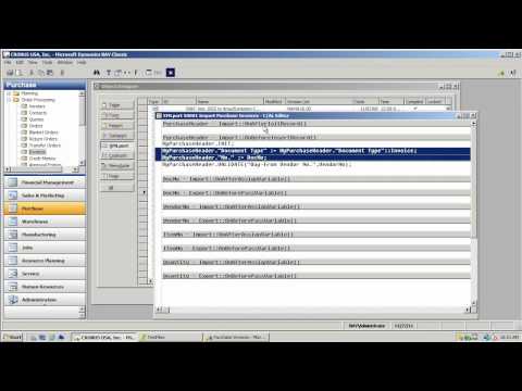

  • DenSterDenSter Member Posts: 8,307
    edited 2016-01-07
    That used to be possible
    https://youtu.be/qNYrmZXUOxE
    That was in 2009 though I think, not sure if it wouldn't work anymore. See if you can make this work.
