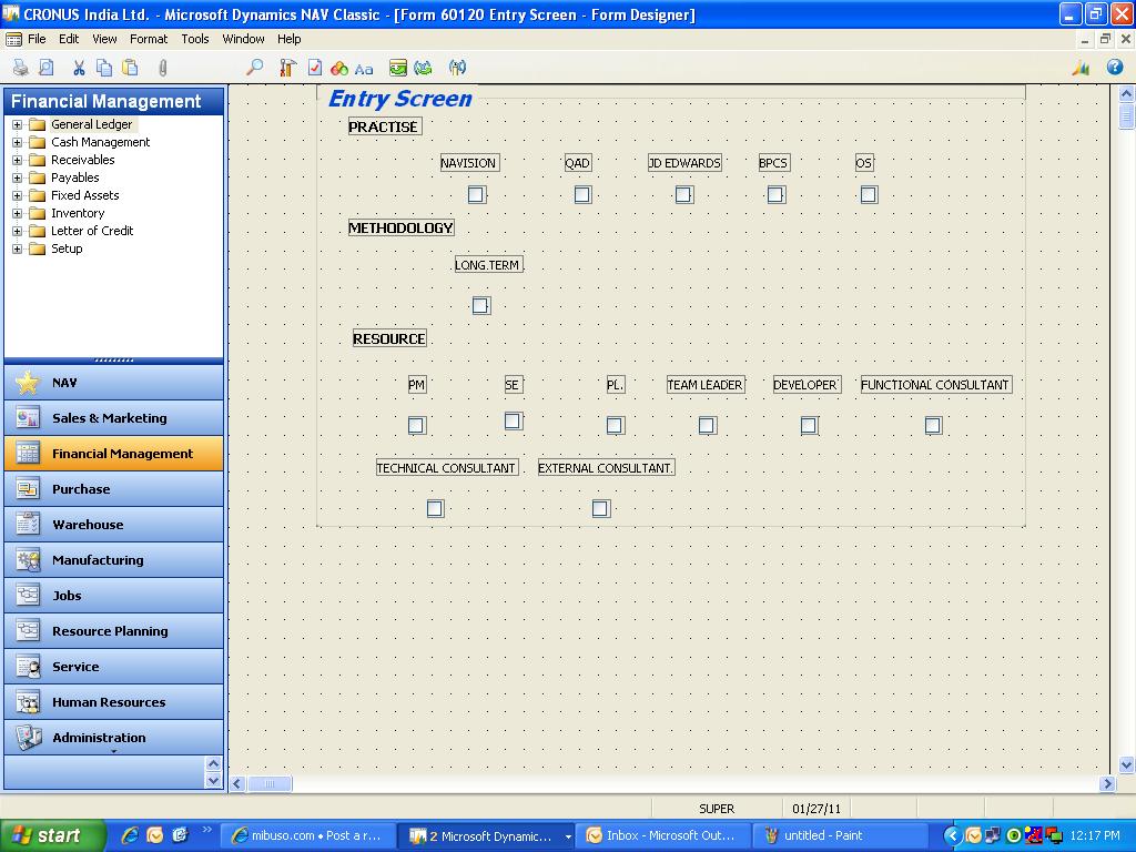

but thats not what i want.....see i will attach my snap here
in methodylogy there are serveral, but i hav kept only 1 here, so when i click the methodology and the resource! only the resurces i selected should appear in the form....
can you understand dear?smile always

no thats the design screen i have! as shown user will select the methodology and resouces...culmination of both will open an form with as the prescribed metholody and resources....
i totally have 6 phases.....And all are shown in Long team.
say i have another methodology called short team....in this only 3 phase are shown...and the corresponding resources are selected! so this should result in only 3 phases visible in the form with the resources field selected!....
'm i making it clear or confusing?smile always

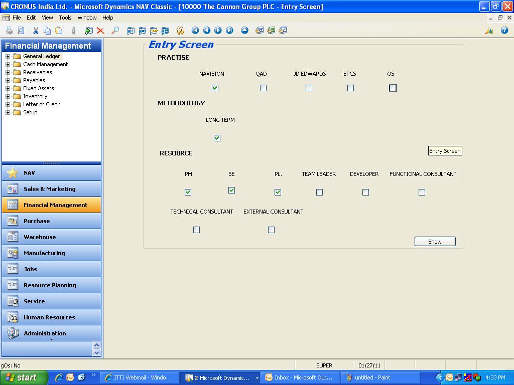

Hmmm...What i though is when you select the practice, the other checkboxs regarding NAV will be activated...then on that you select the Methodology....then the checkbox for resource should be selected.....finally the form opens....
clear?smile always

oh just thought the same....sorry for late reply....went for a conference...
i have added a button called SHOW...now i suppose i need to write all my codes in this.smile always
shona
That which you seek inside is that which you find outside0 -
Yeah.. true...can you tell me what you want to display on your form which is going to open on button click?0
alok_dida wrote:Yeah.. true...can you tell me what you want to display on your form which is going to open on button click?
oh i thought you knew that....
see i hav a unitwise Estimation form....it has 6 phases....
the methodology is based on the how many phases you need to show!
And i hav 8 resources.....so depending on that the user wil select the resources he/she needs!
finally when show is clicked..the form opens with all the selected filters...some thing like this..smile always
