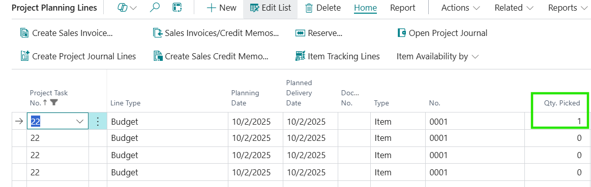

Hey Buddy @cegekaJG ,
Seems some top custom code might be impacting this, system will never copy Qty Picked. Still I tried attempting the same and behavior was all as expected. See the first one was original and last 3 copied one -

@RockWithNAV, like I said, the scenario is copying project tasks to a new project, not the same one. Also, the default code implicitly copies the field "Qty. Picked" when using the following command:
TargetJobPlanningLine.TransferFields(SourceJobPlanningLine, false);
The code has to reset the fields explicitly, otherwise they will be identical to those of the original line. Since the field in question isn't being addressed, it should be the same, right?
